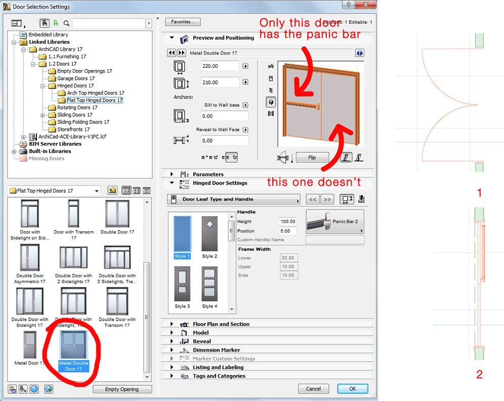

Is there a way to have panic bar on both leafs of a double door? I tried but it only gets on one of them. I want both to be opened by pushing the panic bar.
And still regarding the panic bar, can it be seen on the floor plan? i atach an image in which the disabled have this door and it can be seen.

Whether you can change the hardware configuration or plan display depends on the specific door you are using: these could be options if they were scripted into the library part. For example, in the US Library there is D2 Commercial Door 17 where under the Door Panel parameters you can pick the type and location of hardware for each panel, but there is no option for showing the panel hardware on plan (2D Symbol). If you post the name of the door you are using (it can be selected and copied from the library part's Settings > Previewing and Positioning panel), someone familiar with the part may be able to help.

An image speaks more than many words.
That is the door that i was talking about. On the right there is the 2d view of that door without the panic bar. I managed to set it to projected and then i saw the panic bar in 2d view, but the door is now closed.
Any ideas are appreciated.

Definitely a buggy (or incomplete) door object in the INT library. I downloaded the door you show and see the issue.
The US library's D2 Metal 17 works the way you want - can select right or left inside or outside for placement of whatever handle you want. But, it doesn't seem to be available for download. If I enter D2 Metal 17 in the Door Settings search box, I get your door and lots of other ones as available for download, but not the US 17 doors. I think this could be because the US door library requires so many US macros. Posting just the object for you wouldn't help, as it requires so many other things inside the US library. Not sure what to suggest...short of faking it by modeling the other panic bar as a separate object (moprh).
PS As David said, the US part will not show the projected handles in plan in symbolic view (door open according to 2D angle setting) - only in projected view (door open according to 3D angle setting).

Thanks guys for bringing up this topic. It is indeed not possible to assign panic bar to both panels with the INT library. This has been reported to our library team. Also for both panels independent settings would be the best.
