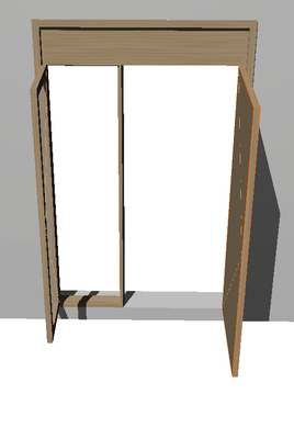

I am trying to model a double asymmetric door with a transom.
The trick is the panels don't have the same style and the transom neither.
Kind of the same as in the image but without the frame in the middle.
How would you do that?
Thanks a lot for your help!

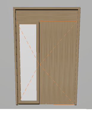

I would just modify my doors code to do so, but you may just need to save a custom door.
Or look at the ci tools I am pretty sure their doors can do that.

Open the Double Door Asymmetric and in the Master Script set gs_door_transom to 1. Save as new object.
Is not perfect, but works with most doors.

Thought it would work and even tried to download another door from Archicad 22 since I didn't succeed with 24 but it still doesn't work 😞
Many parameters are greyed out after the box "gs_door_transom" checked
Is there a special way to do that?

Change in the Master Script.
