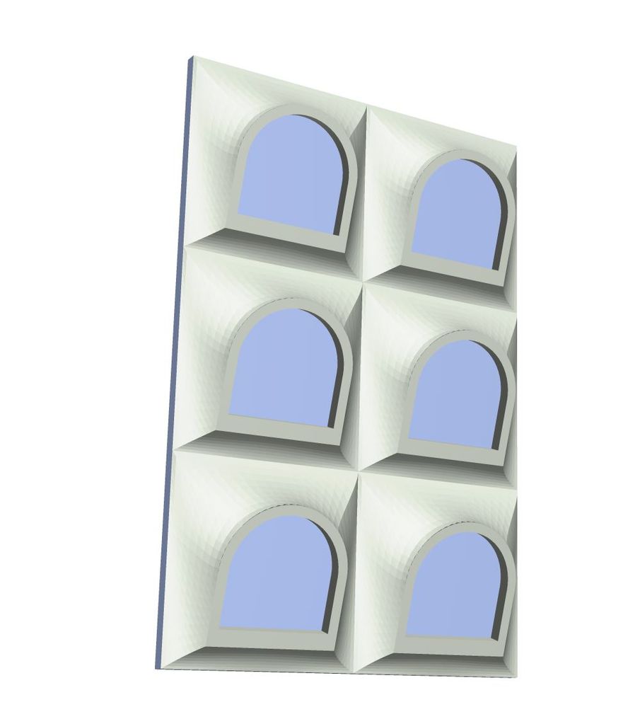

Hi Ignacio,
This is a study case for the mesh tool.
Few polygons, and fast 3D.
Attached, the object.
Of course, dimensions are pure fiction.
Cheers
That looks great. How did you get the mesh to have hard edges on the arch and soft edges on the curved sloping part?
Open the part and look at the code, there are some comments.
Contour
x, y, z, 15 : hard edge
x, y, z, 15+64 : soft edge
Mesh
x, y, z, 0 : hard edge
x, y, z, -1 : soft edge
Mask = 1+4+16+128
In the fragment 1 of 2D window, i put a sketch for construction method.
Tell me if something is not clear.
Cheers
Some remarks to complete.
Lower part needs to be symetrical. I just noticed this when i first started to build a half part.
Rounded top hole : last junction points (profile 14) must be perpendicular to the vertical side,
to get a smooth junction. Coplanar faces must be parallel (symetrical axis).
In any case, you have to define your profiles. Don't trust any software for doing this automatically.
You would loose any control.
You can add as many additional points as you want in the buffer, if you need more precision.
For eg, a reasonable polycount for fast 3D, and more points for section or details.
if GLOB_CONTEXT = 4 or GLOB_CONTEXT = 7 then
put x1, y1, z1, -1,
xn, yn, zn, -1
endif
For sure it is better to use a true wall for insulation and window.
Delete the unnecessary code. Just preserve fragments 2 and 3.
The object will be "light" and fast.
Cheers
