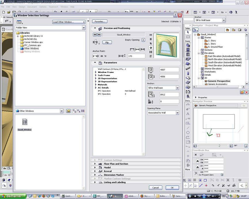

.....after a few more tweaks of the mesh and some SEO subtractions here and there, the final object is saved as a window as shown in the final window object tool below. And then just select it and place in the wall as required......
........final compilation of created windows in wall shown in the 3D perspective window. As I mentioned earlier, I did it hurriedly and with few contour curves hence the low resolution mesh
( which I know I can probably change in the GDL 3D script definition, but didn't want to because it was already dragging and slow as it was in the 3D window; Note to Graphisoft - ArchiCAD NEEDs some form of geometry instancing or referencing for heavy-poly objects, and especially library objects, to allow for more complex modelling in future versions. ASAP. like yesterday; no seriously, this is a feature that is like 2-3 versions long way way overdue).
also, I noticed that when one creates an object using the mesh tool and then saves it as a library part or object, it looses it's Automatic smoothing of ridges in the 3D window as in the native mesh tool/objects. Why is this? It's not too much of a biggie except when you have to export that model or render it using a 3rd patry plugin like the Maxwell plugin where the smoothing is completely lost.....
