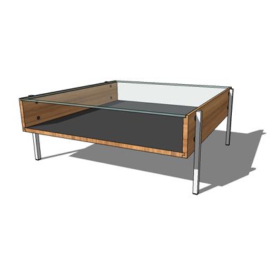

Ok, here it goes. I'll download the object from Formfonts as a DWG. I then go into archicad, open the object and save it to the embedded library. After that, I go back into the object to place a thumbnail, and clean up the 2d object. I do this because we are placing the object into floor plans, and most of the time the 2d image is way too complicated. All of this goes off without a hitch. I am running into problems with the size of the object. For example, I have downloaded a coffee table, and when I open the object in archicad, the dimensions are something like 77' x 73'. Yes, that says feet and not inches. Simply altering the dimension does nothing. I'll save it, re-open the object, and the dimensions will be back to the 77x73. I have gone into details and made sure the box which says "fit size to 2d symbol" is checked. I have also made sure the 2d symbol is the proper size. This works to an extent, but then the 3d object remains enormous. I can manipulate the object after it has been placed into a drawing, however we want to be able to place this object without having to manipulate it. This will save us time and create a graphic standard. How can I fix this problem?

Hard to tell from your screenshot where the problem is. Usually the first thing I'll try is dividing the dimensions by 12 to see if the dwg unit translator is off; using a foot instead of an inch or vice versa. I get 6.4' x 6'; I don't know the dimensions of the table, but does that sound right?
Google-ing the title of your object, I see the design is all rectilinear, see attached image. This would be very easy to model with slabs and then save as an object. Drag a fill the size of the top into the 2D window and then you can set a masking pen so you don't see the floor below. Take a look at the GDL beginner guides, specifically David Nicholson Coles Cookbook, and version will suffice for what you are doing. A search here will provide some links to the online version.

The other possible thing to try is to divide by 25.4, since 1 inch = 25.4 millimeters.
Then you would have a coffee table with dimensions of about 3 feet by 3 feet which also sounds about right.
So maybe in your DWG Translator, the conversion unit should be set to 1 millimeter instead of 1 inch.

In that case activate File\File Special\DXF-DWG Translation Setup menu command and in the Dialog, select the Translator set as default for import in the Available Translators panel at the top. It is usually the 02 For editable import Translator. The icon next to its name shows. Then go to the Settings in Selected Translator panel and select 1 millimeter as value in the Value of 1 DXF/DWG Drawing Unit in ArchiCAD field.
Save Settings and Close, then import the DWG.
