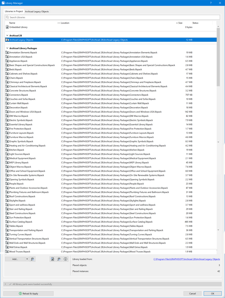

And let me add, that since Library Management is a critical part of BIM Management in any ArchiCAD firm, I think the jury is still out on whether many of us want to switch away from a monolithic library to these Library Packages because the list of loaded libraries gets so long, it becomes hard to troubleshoot and find the needle in the haystack.
Here is what the user sees now in the Library Manager:
We can't even see all 49 of them without scrolling. Much less understand which ones we need to add or remove, when there is a problem.
I'm just sayin'...  🙂
