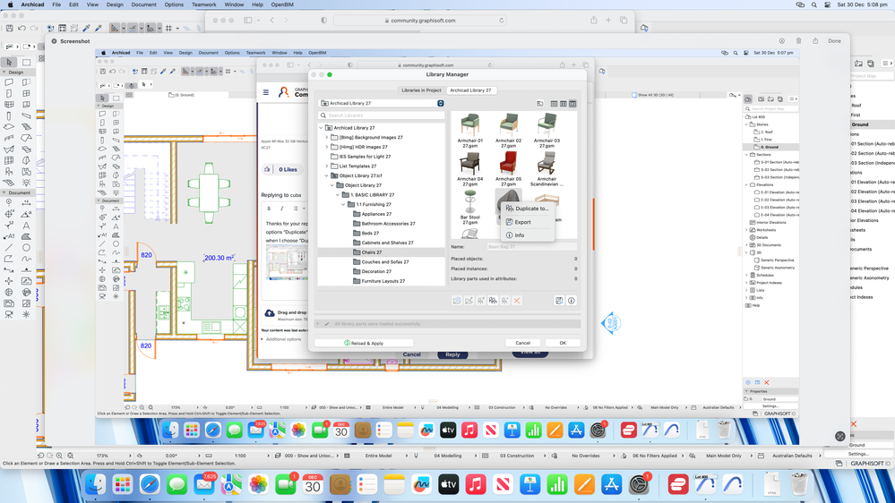

Hi, new to Archicad, I found the furniture through the library manager, pick the object I want to duplicate into the embedded library and click OK to all that but when I go back into my furniture folder in my project, the added objects aren't there. Where do I find them so I can place them? How do I get more objects in my furniture folder where atm I only got 4 objects that were there when I first started the drawing

Ronarc
Thanks for your reply,
when I find an object that I want to bring into my project and right click on it,
I only have 3 options "Duplicate", "Export to..." or "info"
when I choose "Duplicate" I can't find the path into my current project, so I put it into the embedded library but , I can't find the embedded library when I go to the object tool

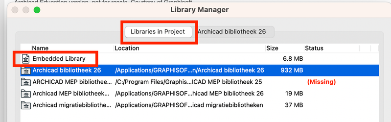

cuba
The lcf library is a container, you can only duplicate.
You can find the embedded library if you press libraries project on top.

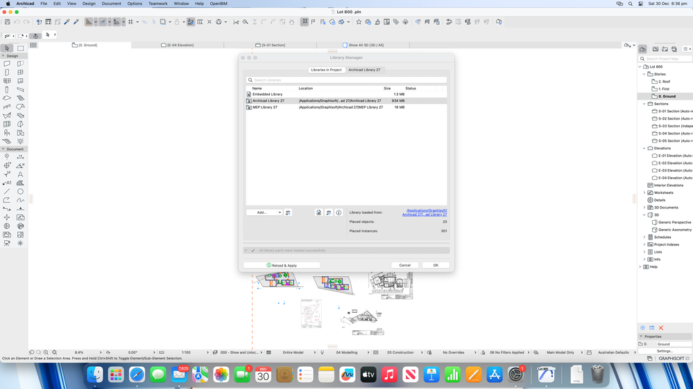

Ronarc
I can see "Libraries in Project" which contains Embedded Library, Archicad Library 27 and MEP Library when I'm in the Libraries Manager, but I can't find them in the drawing command list (the chair - object tool)
When I go through Object tool I can see folders Ceiling, Interior Office, Interior Residential, MEP, Roofs, Site, but in the Interior Residential folder there are only the 4 objects that were there to begin with that I didn't put in there
