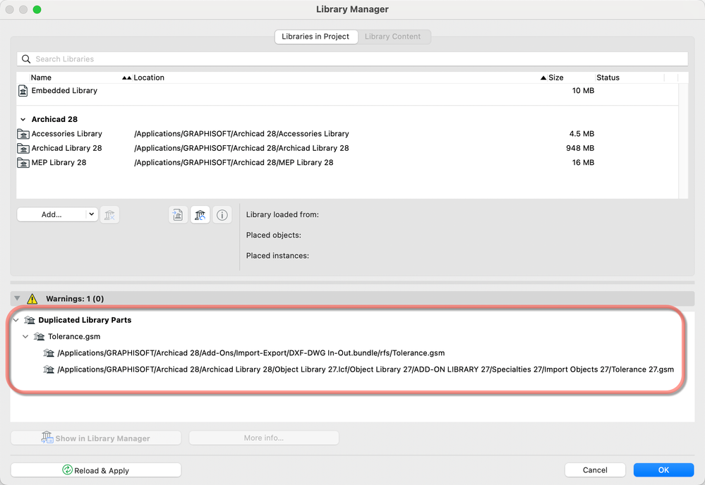

There is a duplicate object (Tolerance.gsm) when following Option 1 instructions for Archicad 28 Migration.
Operating system used: Mac Apple Silicon Sonoma 14.6.1

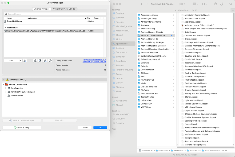

I tried to follow your instructions but none of the parts in the Library Packages load if they are in a folder and I try to load the folder as a monolithic library.
Here is what tried:
- Starting with the default USA template "AC28 USA Template.tpl" I see that it is loading 48 library packs of the 77 provided in the "Archicad Library Packages" folder and one LCF file, "Archicad Legacy Objects USA.lcf",
- So I copy these 48 LibPack files and the LCF into a new folder called "ArchiCAD LibPacks USA 28"
- Then, in the Library Manager, I unload the separate LibPack files and the "Archicad Legacy Objects USA.lcf" and load the new ArchiCAD LibPacks USA 28 instead.
This results in 386 missing parts.
Indeed, the only parts that load while in the monolithic folder, are the ones in the LCF.
What am I doing wrong?

Hi @Ransom Ratcliff ,
The steps you were doing are almost perfect. One thing: when you want to load the content of ArchiCAD Libpacks USA 28 folder do it in a way that you select all the libpacks within the folder with Cmd + A.
Regarding your previous message about the arrangement of the packages: There are multiple arrangement needs from users contradicting each other. Picking a certain arrangement would have deprived a group of users having them arranged in a way necessary for them. That's why we went for providing the liberty of arrangement. This doesn't mean that the thinking has to stop here, we see your point.

2025-03-04 02:49 AM - edited 2025-03-04 05:00 AM
We have our own DWG translator file loaded from the server, I removed the AC28 DXF-DWG In-Out apx from the Add-Ons folder on C:drive. This resolved the duplicates of course but creates a missing export element for publishing, for which I was not able to replace with our own. Now, how to edit the original apx file in order to remove the duplicate?
Update: Should have known there wouldn't be a simple fix. Thought it would be easier to replace the APX file than edit the LCF lib.
Update: So going back to Ransoms original solution: I unpacked the Object Lib 27 lcf , removed the Tolerance object then re-packed the lib and re-uploaded to the BIM. No issues & no duplicates.
