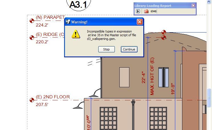

I am facing lots of problems while loading a library. I have tried for loading the Library from the Local and Network.
Can anybody give me any idea on whether the ArchiCAD Default Libraries and other Company Libraries should be put on Local Drive or on the Network Drives?

You should be able to load libraries from both. However you will notice significant slow downs if you load them from the network and may even time out if your server is really slow or has alot of traffic. It is better to put your libraries on a local drive and use something like Allway Sync (for PC) to update the libraries to everyone on your network. There are lots of other programs around that do the same thing, depending on what platform you are using.

Actaully i only just looked at your screenshot closer after posting the previous message. Still follow the advice to put your libraries on a local drive but to your exact problem...
You have over 6000 library loading errors!!!! I am guessing you probably have many libraries loaded at the same time that have similar names. This is most proably the cause of your problem.
Either get rid of your duplicates, take away some of your duplicate libraries or if you have converted the project from a older ArchICAD version then try saving the project using the original ArchiCAD version as a pla. Then in the new version load only the libraries related to those libraries and load the pla from the previous step.

If there are thousands of library loading errors, one of its reasons is that the user has extracted the LCF file containing the Object Library.
Since ArchiCAD loads the ArchiCAD Library, after the extraction it will now contain the Object Library.LCF file, plus the Object Library folder, so each object in the Object Library will give a duplicate error.
Of course this can be easily remedied by modifying the loaded libraries.

I wouldnt think so, It is most likely that the problem lies around you loading libraries with 6000 errors. Better to check this throughly before looking at hardware problems.
