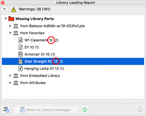

If an element, which uses a GDL object (like a Zone that includes a Zone Stamp), is saved as a Favorite and the GDL Object is missing from the Library, the Library Loading Report lists it under ’from Favorites’. (Those elements are shown on the Favorites Palette with a question mark as well.) If you check those elements in the Loading Report, you will see that after a number is written, for example, '10' or '12'. It means that the missing Library Parts are coming from Archicad Library 10 and 12.
Add the Old Migration Libraries to the project as well. The folder is located in the Archicad Application folder.
  • Open the Library Manager (File/Libraries and Objects)
  • Click on the ’Add’ button
  • Select ’Old Archicad Migration Libraries’ from the Archicad Application folder
  • Click ok

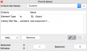

  • Open the Find and Select (Edit/Find and Select)
  • Define the Criteria:
    • Element Type is Object
    • Library Part Name is stair-basement-f (1) (Tip: The name of the missing objects can be copied from the Loading Report by doing a right click and selecting ’Copy’)
  • Click on the '+' icon to select the elements that meet the defined Criteria
  • Delete the selected elements or replace them
  • Repeat it on all the other stories

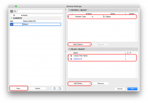

  • Create a New Schedule
    • Open the Scheme Settings and click on 'New' (Documents/Schedules/Scheme Settings)
    • Add a name and click Ok
  • Define the Criteria and Field
    • Criteria: Element Type is Object
    • Fields: Library Part name and Element ID
  • Click ok

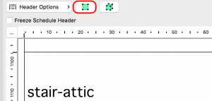

  • Select the missing Object in the list (identify it by its name) and click on the Select on Floor Plan  icon to view the element in the 2D

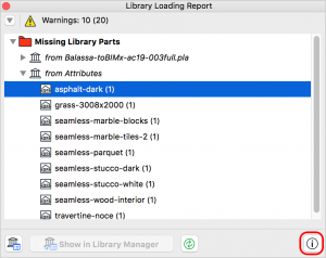

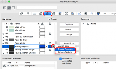

The listed Attributes are missing because they are not part of the Archicad Library, they are custom elements/pictures/surfaces added to the project. They can be added to the Embedded Library or compressed into an LCF File, linked to the project. If their source is lost, they need to be either replaced or deleted from the project. Select a missing Attribute in the Library Loading Report (Window/Palettes/Library Loading Report) and click on the Info button. It will show the name of the Surface using it as a texture.

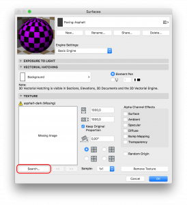

  • Open the Surfaces Dialog (Options/Element Attributes/Surfaces)
  • Select the Surface
  • Replace the Texture by clicking on ’Search’ and add a similar Texture from the listed Libraries to the Surface
Since Archicad 22 the Texture of the Surface can be easily removed or replaced in the Attribute Manager  (Options/Element Attributes/Attribute Manager) as well.
