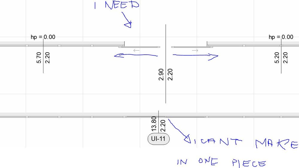

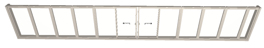

Hello, I need some help, please. I want to create a transparent wall with 10 fixed panels and a double sliding exterior door in the middle, but I can't figure out how to set the number of panels from the window options, nor from the sliding door options.

Have you tried using curtain wall? It is maybe a simpler way to achieve this.
It will be only one element and you can define the center parts to be sliding doors, facing outwards, with 2 fixed frames each that you need to account for.
This way you have more flexibility with the layout.
Also, when placing markers, you can use the autotext label to assign a label to individual curtain wall panels.
