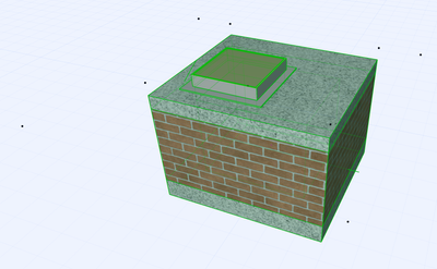

I have a 3d representation which looks like this:

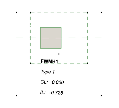

I have a 2D representation which looks like this:

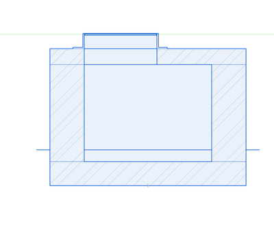

This is the Section view:

1. Why are the building material hatches as defined in the file not showing in section? The surfaces are applied properly from the materials in the 3D view
2. I can't get the text labels to be permanently horizontal if both the view and symbol are rotated. I've tried so many different things that I suspect I'm getting 'snow blind' with this.
This is the subroutine for the text:
"2dtext":
! textHeight_2d=textHeight_2d*1000
rr = request ("View_Rotangle", "", ang_view_rotation)
rs = request("Height_of_style", "fontType", text_height)
! text_height = text_height * PAPER_TO_MODEL  ! only used for 'add2'
! rot2  -ang_view_rotation ! rotate text to horizontal when view is rotated
! Actual rotation of the 2D symbol:
_totalRotate = (SYMB_ROTANGLE + ang_view_rotation) MOD 360
rot2 -ang_view_rotation ! doesn't work with rotated symbol and rotated view
!rot2 _totalRotate ! God knows what this is doing...
pen TextPen
define style "LabeltextNormal"    fontType,   textHeight_2d*10,  7, 	0
define style "LabeltextBold"    fontType,   textHeight_2d*10,  7, 	1
define style "LabeltextItalic"    fontType,   textHeight_2d*10,  7, 	2
define style "BodytextNormal"     fontType,   textHeight_2d*10,  7, 	0
define style "BodytextBold"     fontType,   textHeight_2d*10,  7, 	1
define style "BodytextItalic"     fontType,   textHeight_2d*10,  7, 	2
if fontstyle1="normal" then style "LabeltextNormal"
if fontstyle1="bold" then style "LabeltextBold"
if fontstyle1="italic" then style "LabeltextItalic"
Text2 A/2,0, MHnum
Add2 0,-textHeight_2d*1.5
if fontstyle2="normal" then style "BodytextNormal"
if fontstyle2="bold" then style "BodytextBold"
if fontstyle2="italic" then style "BodytextItalic"
Text2 A/2,0, MHTypeRef
Text2 A/2,0, CL_label
Text2 A/2,0, IL_label
del top
RETURN
It doesn't work for me, it's possible I've done something stupid, I'm sure some of you GDL experts can fix this really quickly!

Could you share the part of your 3D scripts where you define your materials/surfaces.
GDL uses following directives for these:
For connecting to MEP-elements, I would suggest looking into Create Custom MEP Part, and especially using the "MEP Connection Object". Remember: you can copy/paste code between GDL-scripts, or even drag objects into the script-window (up until AC26)... In Archicad 27, you can generate 2D/3D based on a (floor plan) selection.
Hope this helps/clarifies.
2023-12-16 06:40 PM
I was using this:
cprism_ buildingMat_base, buildingMat_base, buildingMat_base,
 	4, baseThk,
 	Corner1_X, 	Corner1_Y,  15,
 	Corner2_X, 	Corner2_Y, 	15,
 	Corner3_X,	Corner3_Y, 	15,
 	Corner4_X,	Corner4_Y,	15
But the materials didn't work in section.
I have added the following line before the cprism definition, and it works fine now - thanks a lot!
SET building_material buildingMat_base, fill_pen1,fill_pen2, 0

The text is fixed and 2d hotspots all work fine.
