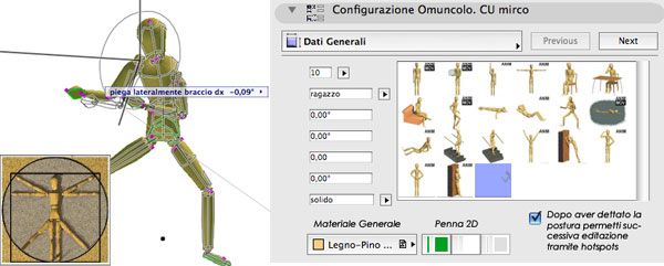

I think this can help you
If you are interested, I can attached into Depository.

Hi Dwight,
You have right.
The file is not complete
I can upload only 49,084 kbyte.
In the forum the limit is 256 Kb
Omuncolo is 572 kb (24 byte code plus 540 ca UI images )
I can't upload code without UI_images.
This is the link to my web site resource.
http://www.3dsmile.it/index.php?option=com_docman&task=cat_view&gid=229&&Itemid=73
I delete the file into discovery category.
