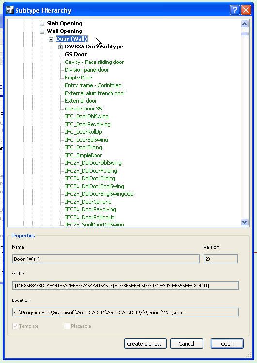

It has the same GUID as the library part editor.
I would have thought the library part editor would show the library part GUID but apparently not.
Hence why it doesn't change when you duplicate (save as) a library part.

Converting the object to XML with LibDev Toolkit gives following info of the GUIDs;
<?xml version="1.0" encoding="UTF-8"?>
<Symbol UNID="{D20C9049-8F3F-11DA-A9BA-000D9344841C}-{870979BF-268E-4ACC-95DA-36A414FADA41}" Owner="1196638531" Version="23" Signature="1196644685" IsPlaceable="yes" IsArchivable="no">
<Ancestry SubIdent="0" Template="no" SectVersion="1" SectionFlags="0">
<UNID>{F938E33A-329D-4A36-BE3E-85E126820996}-{6CBED0C3-B08B-400F-AEC9-9625C3F2321D}</UNID>
<UNID>{103E8D2C-8230-42E1-9597-46F84CCE28C0}-{257A7271-109C-4C99-821D-566C0EAB2395}</UNID>
</Ancestry>
<!-- GDL SCRIPT ===== GDL SCRIPT ===== GDL SCRIPT ===== GDL SCRIPT ===== GDL SCRIPT -->
When the object is converted back to GSM the first part of the UNID {D20C9049-8F3F-11DA-A9BA-000D9344841C} remains static.

Converting the object to XML with LibDev Toolkit gives following info of the GUIDs;that is exactly what I thought - GUID is just a set of pointers to data structures as you can see them exploded with XML.
</Ancestry>
