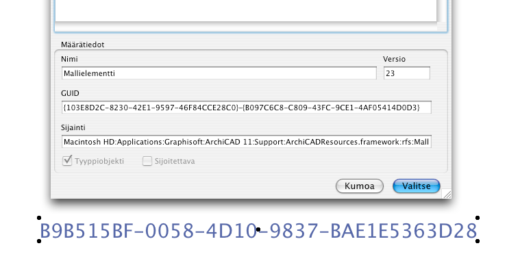

Where do you check the GUID of the library parts? I just tried what happens if you open and "save as" a library part, and it did get a completely new GUID. I used the "open object by subtype" dialog to check the GUID of the parts:

I was looking at the GUID with the "Select Subtype" button in the object script editor.
I just tested again and "saved as" with exactly the same name in a different folder of my library.
The object name is exactly the same and the GUID is exactly the same.
I re-loaded the library and there was no duplicate names or GUIDs reported.
I even just chamged the script of an object and "saved as" with a new name.
GUIDs are identical still.

OK I just found the "Open object by subtype" in the work environment.
Interestingly the objects have different GUIDs there.
{85C05AE9-D27A-43DA-A52F-8C91A8FCBD61}-{6FF8DD5C-4B85-46B1-9E61-C9EC8C3984E7}
{4E5DB834-4BCA-4664-85CD-323228FD5A43}-{6F91FBA6-5E0F-4B51-8D82-E4A776A75643}
But these are totally different to the GUID show in the script editor (which is the same for both objects).
{103E8D2C-8230-42E1-9597-46F84CCE28C0}-{1237716B-D289-456A-96DF-E82F767D5B0E}

Is there a Request we can use to get the library part GUID?
I know there is the GLOB_GUID but of course that is for the GUID of the placed intance of a particular library part.
Hello,
Global GLOB_INTGUID gives it without request,
but differs from the object dialog GUID

You are right Rob.
As Juha pointed out GLOB_INTGUID is the command to use.
GLOB_INTID was last used in version 10.
But this is the unique GUID for each instance of an object.
It isn't the GUID of the library part.
As far as I can see there is now way to enquire what the GUID of a library part is.
The problem is that the GUID that shows in the library part editor is not the same as the GUID that the library manager users to check for duplicates.
It is not a very important issue as it actually seems to be working fine - just showing the wrong value in the library part editor.
Just been playing as I wrote this and I see the difference now.
The library part editor is only showing the GUID of the subtype group and not the individual library part GUID.
The library manager (or open libray part by subtype) shows the actual library part GUID.
The first image here shows the open library part by subtype dialogue and it lists the individual objects.
This is the library part editor.
Note it only show the DOOR(WALL) subtype group and not the individual object.
