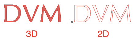

Matthew:
I gave this a try, but still got the outline text in the 2D Window.

You need to set a material in 3D to provide the fill. It's easy to overlook. There are a few ways to tweak it, but knowing your skill level these should be obvious to you.
Yes, that was it.
