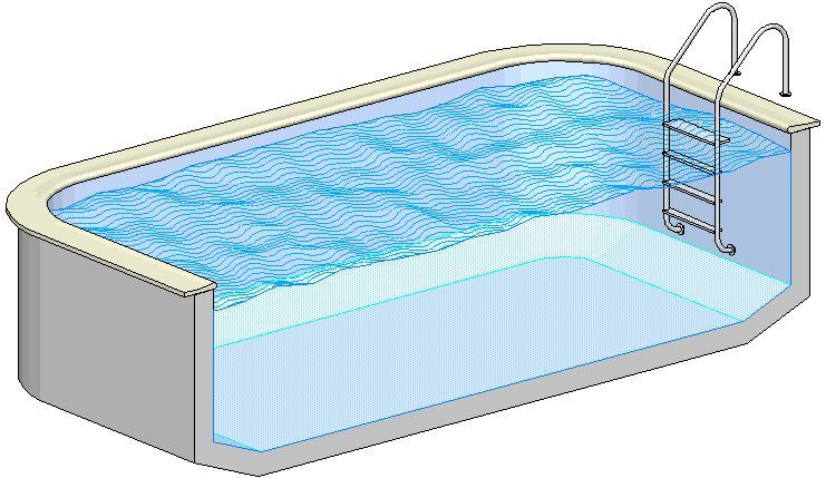

Hello Andy,
What is this "wobbly water" you speak of ?
How is it made ? Is it made with a mesh command,
a mass command, or some other method ?

You can find some pools with "wobbly water", in the library below.
Cheers.
Olivier

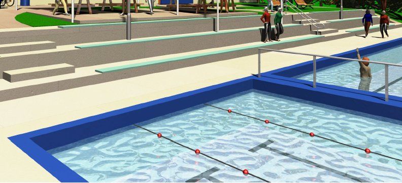

That looks like a pretty large polygon count. The image below shows a pool with a flat surface, with a water material using the LW Archive settings (i think, an old project but can look up settings if you want). Maybe a combination of the two would be good to get an rippled edge around the water, but with less polygons.
... and could someone please help the woman who fell in fully clothed...?
