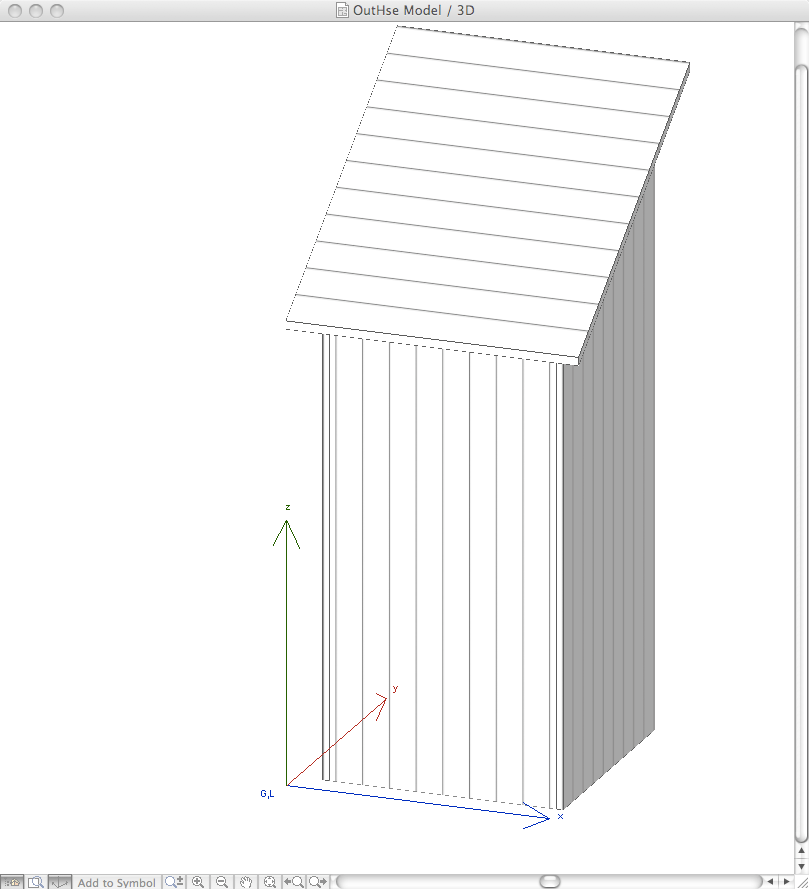

I have created a library part to represent a back woods outdoor toilet typically found in America. I am using the object in a presentation on "adaptive re-use" where I take this primitive outdoor toilet and transform it into a modern living room furniture piece. In the attachment, I need to tilt the outhouse about the "x" axis, so that the top lays down toward the observer. Is there a script that will do that?

Just add an angle parameter to your object - call it say .... ang_x
Then at the beginning of the 3D script just type .... ROTx ang_x
Now you will have an object with a rotation parameter that you can adjust to what ever you need.

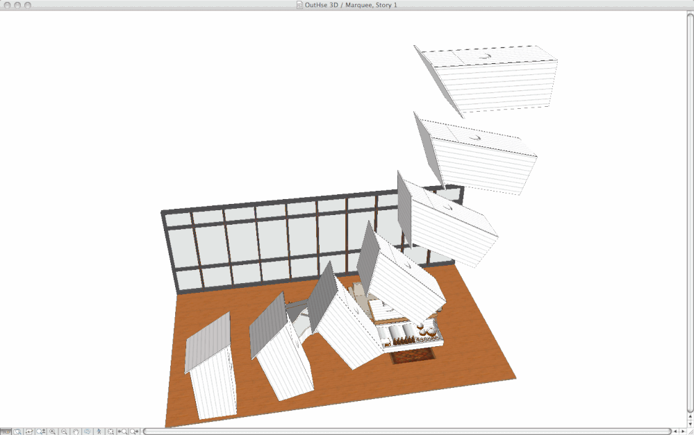

Ooo... Thanks for the scripting tip. It worked for me fine, sort of. I have attached the result, but was surprised. My expectation was that it would have simply rolled down on it's side about it's x axis, but instead, as you see, it kicked up and away, as if the axis was 20' or so higher. Would this have anything to do with having 'built' the original model some place other than at 0/0?
Erich
I assume that you saved the part from the floor plan based on the question asked and the behavior exhibited. If so, then yes, it has everything to do with how/where you built the part. I appears that you built it about 10' away from the origin.
You can do various things to the script to correct for this but it will be much faster to move the part to the origin and save it as a new part. It may take some experimentation to find the correct location, but I would start by locating the portion of the part that you want to rotate around right at the origin.
Sorry I didn't really think about the position you may have saved the object from.
I'm in the habit of creating objects from the origin (0,0).
You will probably find some move commands at the beginning of you 3D script.
i.e. ADDx, ADDy, ADDz, maybe even som MUL commands.
You will want to move the "ROT ang_x" command so that it comes after these movements.
This will put it at the same position that you modelled the object and therefore rotate from its base.
