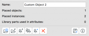

Sometimes the Embedded Library can get very disorganized. It can contain many unused Library Parts which makes the management of the Embedded Library difficult. You can go and check each Library Part if it is used or not in Library Manager:

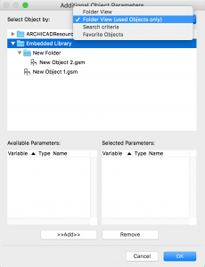

  • Go to the Interactive Schedules and start creating a new object schedule.
  • Go straight to adding fields. Choose to add Library Part parameters.
  • In the opening window (Additional Object Parameters) you can select "Folder View (used Objects only)". In this view, unused objects do not show up.
  • Open up each folder and subfolder in the tree structure in this view.
  • Take a screenshot and save it.
  • Quit creating the schedule as you don't need the schedule itself.

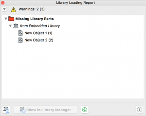

Step 3: Delete the Embedded Library
Delete all embedded Library Parts from the Project.
You will get a warning of missing Library Parts.

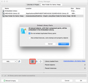

Step 5: Reload Missing Library Parts
Open Library Manager and load the folder (as a linked Library) in which you have all the Library Parts you kept in the previous step. Press Reload & Apply. ARCHICAD finds the Library Parts that are used. The used items of the previous Embedded Library are now parts of a linked Library.
Step 6: Embed Placed Objects of the Reloaded Library
With this step, you can achieve that the used objects will be again in the Embedded Library.
