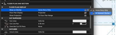

how to cut it but not by making an opening, so if I move the window the wall doesn't have a hole

Delete the top wall and make the bottom wall higher.
Set the floor plan display of the wall to all relevant stories.
