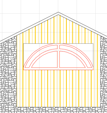

How to make wall heal around non-rectangular window.
Im having a problem with having my non-rectangular window healing to the sides. Is there an easy way for me to fix this. I've tried all that I know, which is not too much since Im fairly new to gdl's.

See also page 1017 of the ArchiCAD 14 PDF guide, "Save Custom-Shape Holes or Niches", in the section on "Graphic Creation of Custom Objects".
Edit: Oops, see you are on earlier versions. It is in the reference guide for those, too. But, since your sig says that you have AC 9, in your Documentation folder there, you will find the PDF "Introduction to Object Making". See pages 24 and 108.
