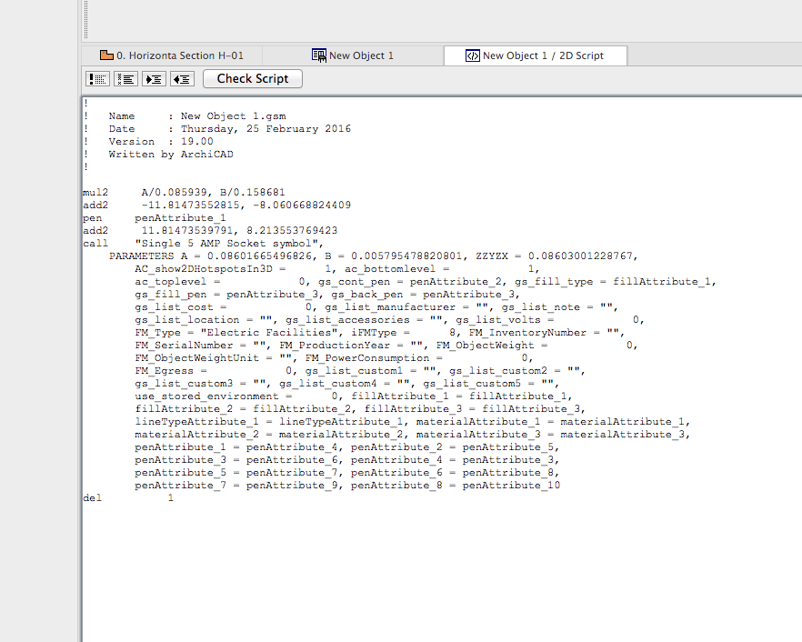

Can You help me, please? I'm stuck on text contents of 2D symbol linked to object. I've made my 3D object, then I've made 2D symbol with text. I have linked symbol to that. Everything works fine until I want to change the scale of drawing. I've done it in scale 1:5 but when I want to change the scale to 1:20 text is bigger than symbol. Does anyone know how to do fixed text contents?
Just in case, I attached screenshot of my 2D script.

Your script doesn't seem to have any text command in it, so I'm concluding that it's in the macro you've called.
In any case, to get things to change size with the scale, you use the global variable GLOB_SCALE as a multiplier.

Let me describe how I do it, because this is might be wrong way.
1. I make the 3D object using morphs - in this case socket.
2. I save selected item as object.
3. I draw 2D symbol using polyline and text.
4. By object manager I'm loading GSM object.
5. I go to properties by alt+cmd+o
6. Then I use fragment2 command in 2D script
7. I paste ready 2D symbol with text to the 2D symbol window
8. I save that as new object.
As I've written in previous post, when I want to change scale of drawing letter in symbol is changing size. I'm not sure where I can use GLOB_SCALE in that script...

Sounds pretty complicated.
In your particular situation I don't know how to help. I would just script the 2D symbol...they're reasonably easy, but you do need to learn a little bit of scripting.

Using the 2D Symbol window of the Object rather than the 2D Script is very limiting, and not intended for the type of control you want. To create a 2D Script for your Object you have two options:
1. Set up the Plan Window and 2D Script next to each other, then drag the 2D elements from the plan into the 2D Script window, ArchiCAD will write the code for the 2D elements.
2. If the above does not work (it can be a bit tricky), hide all the elements in the plan view except for the 2D elements for your object and Save As... ArchiCAD Object File, again the 2D elements will be converted to code in the 2D Script.
Make sure the 3D elements and 2D elements have a common origin (best to use the Project origin) so they align correctly in your object. You are generating the 2D and 3D separately, it is up to the user to make sure the 2D and 3D correspond.
Scripting in GDL gives you more control over your objects, but takes some time to understand. Getting the scale of 2D text to work as desired is a good small project to start.
