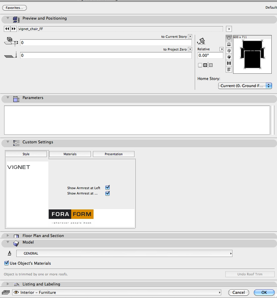

Now that I've got the chairs, how do I change their dimensions ? Below is what I'm presented with when clicking on the objects settings, as you can see, the parameters are all empty...
Thank You
