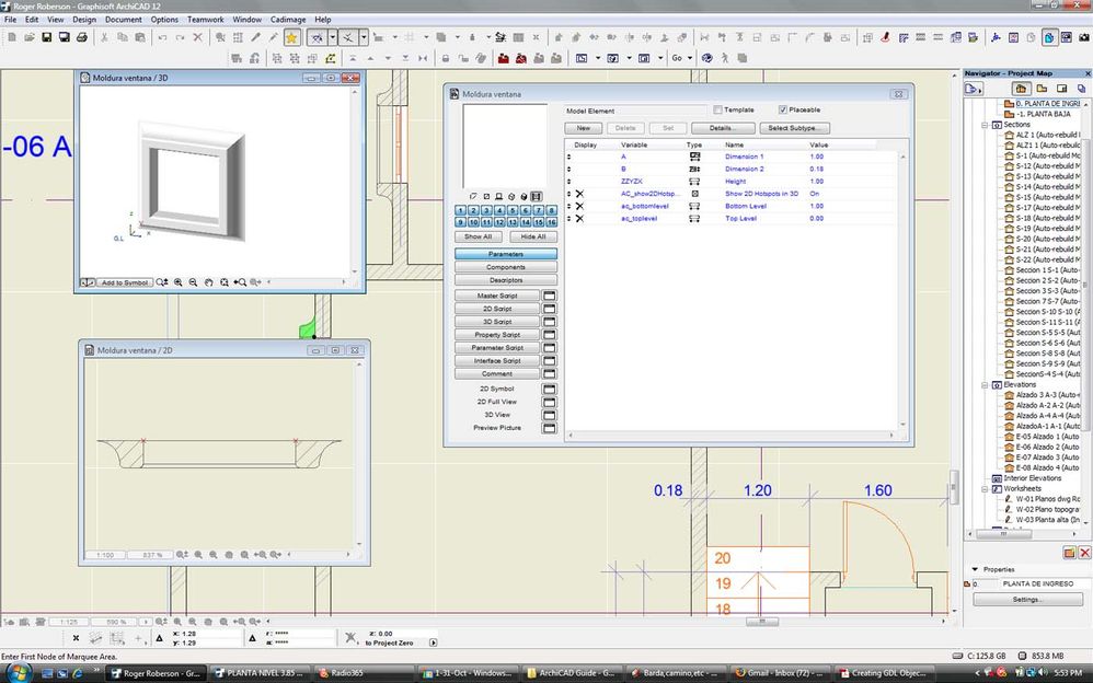

I need help making my object "smart"
I created a frame to place around windows with a molding made from a complex profile, but once I save it as an object and place my object in the plan, if I give a measurement, it's original measurements of the molding changes and distorts, I know now that I have to make the object "smart" but It's confusing and I don't know how to do this,

I would suggest that if you want an editable object you use PROFILER (the add-on) instead of complex profiles. Complex profiles add way too much senseless code to the resulting part...
In PROFILER, you have the same profile and will have a SQUARE (polyline) as the PATH. Once you open up the .gsm, you will be able to identify which number relate to the path and which relate to the profile. (use the gdl reference pdf in the help menu of AC for more info)
Simply replace the path nodes with VARIABLES. Most likely you will want the PATH to match the window opening.... so you identify the INSIDE of your profile as the point of extrusion. Then when you type in A & B on your part, they can match the window opening size.
Profiler will builld the object laying down, so you'll also have to include a rotx 90 at the beginning.

Hi Duane,
I downloaded the PROFILER add-on, I created the molding, but I'm stuck, I'm new in object creation, I apreciatte all your help.
I need to use my frame exactly as you explained it to me, I need to place this frame around diferent sizes of windows and I need to give the inside measurements of the frame (the size of the window).
