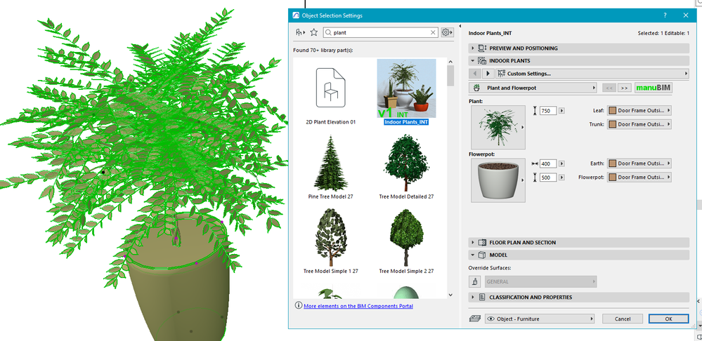

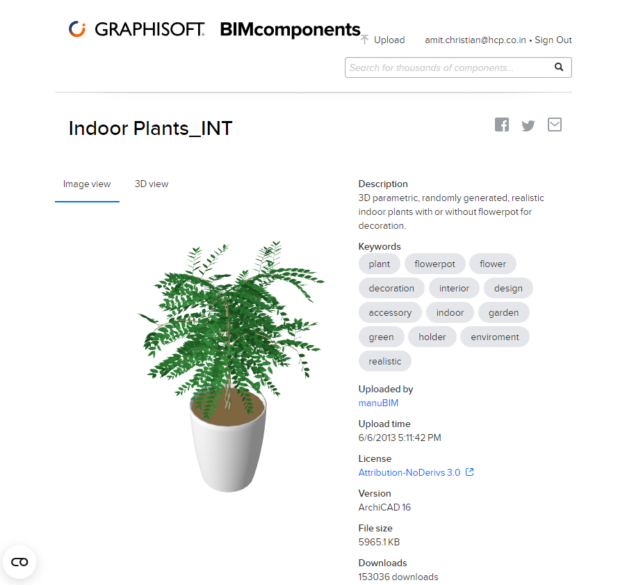

Please review the attached two screenshots. The first screenshot shows that the download object has all surfaces changed to the incorrect surface, "Door Frame." The second screenshot displays the web page with the original surfaces as seen in the image.
Below is the link from where I downloaded the component:
https://bimcomponents.com/GSM/Details/16006

It is not the 'wrong' surface material.
it is just the surface materials in your file have different attribute numbers to those that the object was set up for (ideally it should be set up for the default Graphisoft template).
If I drag it into my template, then you can see the trunk and earth are paint materials.
And you can see the outline is a yellow pen because of my non-standard pen set.
I am assuming yours are all changing to door frame material because you do not even have the actual attributes used, so it is just defaulting to the first one it finds.
Also the script is password protected, so you can't even change the defaults and re-save the object.
You can set up a favourite though that uses the materials, pens etc., that you want as default.

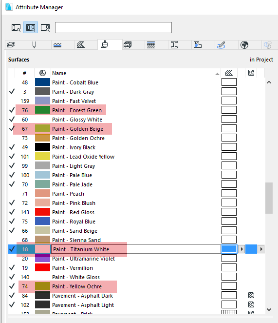

I can tell you that if I load it into the default AUS template it is trying to use surface attributes 76 (paint forest green), 67 (paint golden beige), 74 (paint yellow ochre) and 18 (paint titanium white).
So if you don't have those attribute numbers for your surfaces (you can see them in the Attribute manager), that would be why it is substituting for the door surface material.

These surfaces are index number 70-Paint - Pale Jade, 100-Paint - Pale Blue, 32-Paint - Bordeaux & 18-Paint - Titanium White.
I have confirmed that I have the same surfaces with the same index numbers in my customized template. However, when I place the BIM object in my customized template, all four surfaces change to a surface with the index number 374 - Door Frame Outside Finish.
I’m trying to figure out why this is happening.
