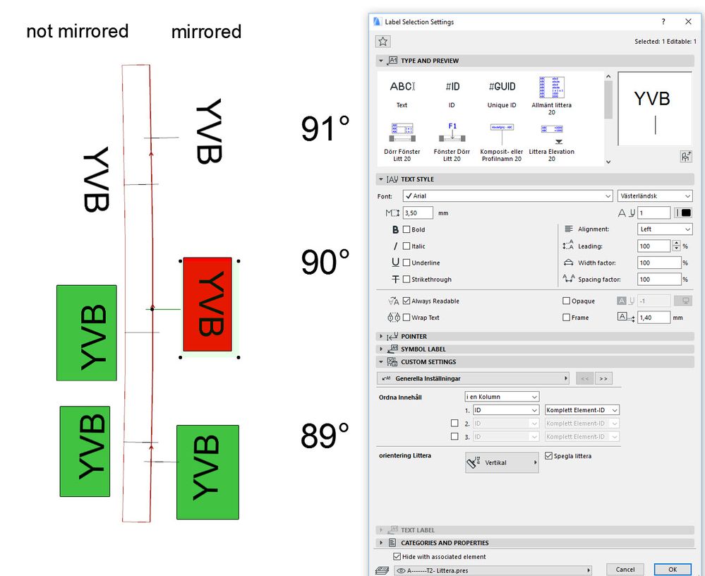

In which macro do I change the text orientation?
Mats_Knutsson
I can't find the macro in which a clever programmer thought the text text in the general ID label should be read from left to right when placed parallell to a wall that extends exactly in the y-direction. I'd greatly appreciate some help here. Sometimes we need to mirror the label just because there is no space elsewhere...and yes...this is the type och graphics we are obliged to use for a wall labe... ID+ a simple line...and the text should be read from right to left...
The green ones are ok...

Your label is set to 'Vertical' rather than Parallel.
I see the same thing but is fine when parallel and "Always Readable' is on.
If you want to leave it as vertical try turning the 'Always readable' off (that seems to work for me).
But now I have been playing with it no matter if always readable or not it remains readable when vertical and mirrored.
Maybe there is a bit of a bug here?
I will try to keep testing (I was using version 20).
Also you are not using the 'ID' label but you are using the 'Identification and Property Label'.

Deja Vu yes! I posted in the wrong forum the first time. This is a gdl thing and I don't know if it's a bug or design mishap...either it's not working and our drawings look like crap. I'll await GS asnmwer for this one since I can't figure out where to change the code myself.
