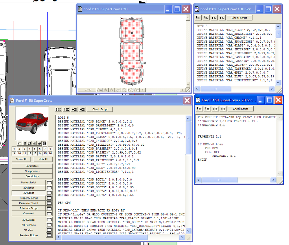

how do I tilt this pickup?
Insert a jack and crank it up? 😉
Add ROTx tilt at the beggining of the 3D script; add new parameter of the angle type called tilt; add DEL 1 to the end of the 3D script.
