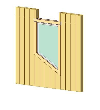

I received instruction from someone last year on how to invert the W Trapezoid Fix 70.win with:
IF Flip then
addy b
Muly -1
ENDIF
In the 3D Script
And adding the "Flip" Parameter with the on/off option.
This seemed to work for 7.0 Trapezoid.
Inverting the W Trapezoid Fix 81 I am missing the wall above the window. Did I forget something? ( See Attached)
Know enough to be dangerous....
Looks like you flipped the window, but not the wallhole. Check the script again, see whether the wallhole is in the same coordinate transformation procedure that governs the window object itself.
