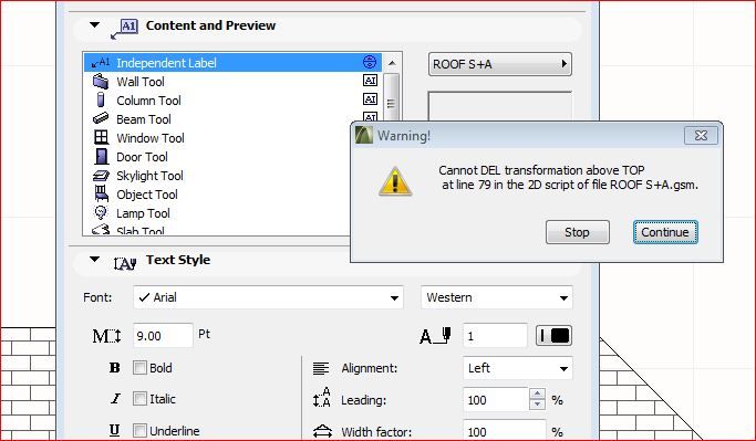

Hi! I tried to load a label to indicate a roof slope, from ArchiCAD GDL Object Depository but this error comes up.
any help will be appreciated
Thanks

Hi, Giuseppe. the object was made by the user archibaldo, did you try to contact him?
I see there is more than one problem in that object, but is always difficult to say what is a choice and what has to be adjusted.
In the following script I modified very little things, so to get rid of the error message, hoping it still works in the intended way. Copy and paste it in the 2D Script of the downloaded object.
