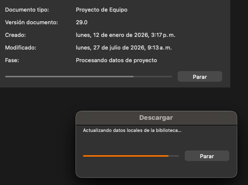

hi, also have the same problem with teamwork project AC29, take a very long time to open, compare with AC 26
Monday
- last edited
Monday
by
ENDLESS LOADING
