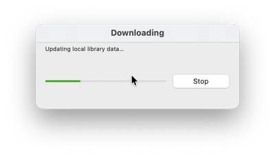

Any feedback from Graphisoft technical team? Our local support promised that this issue would be resolved by Archicad 29.2, but it is still the same. Updating Local Library data still takes ages and it updates even when there are no changes in the libraries. It does not make sense.

As others have mentioned, I have been repeatedly stop-clicking the Downloads dialog to speed things up, but that's just wrong, and it's not the only teamwork operation that is slow.
