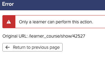

When I follow the link above I receive this:

The link to the Archicad 26 Upgrade Training class should be to its catalog entry:
https://learn.graphisoft.com/user_catalog_class/show/46664
You must sign in to the Learn site with your Graphisoft ID and then enroll in the course to then see the content. Graphisoft has apparently chosen to provide this course free to SSA/Forward customers and for $175 for others. The course description gives the coupon code for free access for SSA/Forward members .
Strangely, in my opinion, they only provide access to the course for 180 days after enrolling. To me, this should be like a Kindle (etc) e-book with lifetime access.
