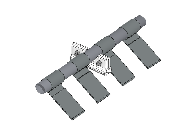

Using Library part make, I made this Snow Guard that is 40cm long. I want to add a aprameter that array or copies it along its x axis. Is it possible?

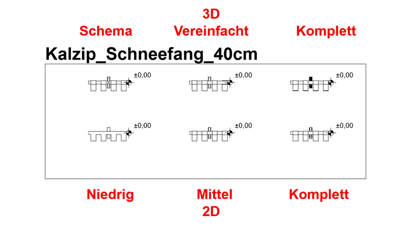

I couldn't find any way to make parametric objects with the part maker. It also doesn't work with pre-made parametric objects from Param-o... or any parametric objects at all...at least I couldn't make it work. But I think you can cheat your solution and instead of 3 variants with different 3D detail level, have 3 variants of the snow guard with different per-modeled length.

You can create a simple gdl object that calls and copies the snow guard (in 2d and 3d)
In the zip file is a quick test.
You can enter the name of the object to be called and choose the number of copies and the level of detail.
The number of copies is divided by the length of the object.
AC28 version
The lmp files are also editable and upgradeable with editable hotspots.
