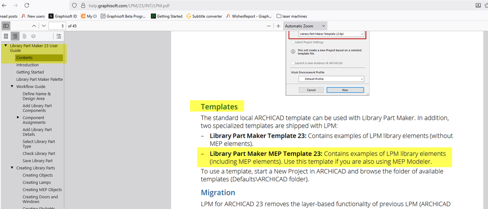

I can not find the Template for the Library Part Maker.
I did Install everything but when I try to find the template is not there.
Many Thanks

Was that just an example image you had shown before?
If so, where did you get that from?
It seems to be from version 23 and is a TPL file created in that specific language.
If that is the language you use, then contact your local distributor and see if they know.
It appears to be using the exact same examples as in the help file, which suggests it is a Graphisoft file.
It isn't included with the LPM installation that I can see (unless it was different back in 23).
I have never seen a sample file for LPM.
I just found the version 23 user guide and it does mention templates.
But I see nothing similar in the 29 help files.
You could install Archicad 23 and then LMP 23 to get the template.
I don't think you can just install LPM 23 without Archicad 23 - but you could try.
You don't need to run it, just install and find the TPL files.
