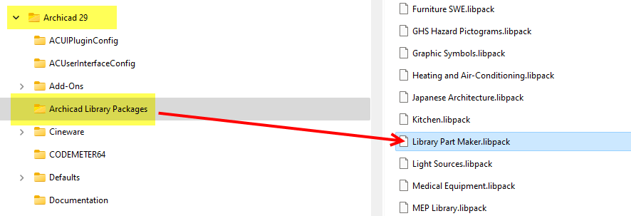

Have you loaded the 'Library Part Maker' library pack?
This needs to be loaded in addition to the other library packs.
Xavi
Hello Barry
Where I can find the  'Library Part Maker' library pack?
Thanks
Once you have installed the add-on. the library pack should be in the Archicad Program folder with all of the other library packs.
Xavi
Thanks Barry, I did found.

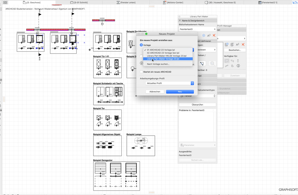

Xavi
By Template I mean Template. Like this one on the screenshot.
Is a german version, but ddi also exist a international.
This Template comes with Window and door example.
I wasn't aware that there is a template.
I understand that you add your own design area and components.
But I am not a user of LPM.
I see at least some of the samples in your template image are the same ones shown in the help file that I linked to.
I haven't read through it all so am not sure if there is a link to a sample file in there.
I didn't see one after having a quick look.
There must be a file somewhere if those examples are the same.
I just don't know where.
Anyone else have an idea?
