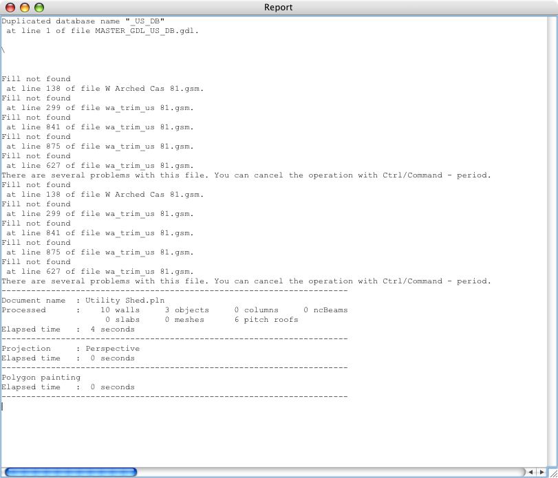

My library parts are not working right. When ever I select one, say a window, and place it into a wall I get several messages that files can't be found in the GDL script and a couple others. What could be wrong??
Here is the report of everything wrong when I use a window. This just started happening and I don't know what could be wrong.

The fill is showing as missing in structure property in wall.
And even in fill type 2D ,its not showing the fill.
Under surfaces also am not getting the fill.
I have attached the images.
Default layers are also not showing.
I reloaded the library. There is no problem in library loading.
Please help me in this.

Find a relevant file that has the missing Fills and Layer Combos then import them into your current file using the Attribute Manager?
Roopa A
Thank you,
It's working fine.
Loaded fills and Layers by this method.
Thank you so much.
