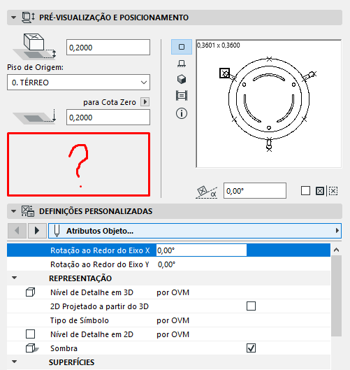

Hello everyone,
I've recently started using the Library Part Maker (LPM) to create custom objects for my firm. So far, I've made good progress using Graphisoft's manual and successfully created some objects. However, I've encountered an issue: I can't resize the objects after saving them.
When I open the object settings, the input fields for parameters like A, B, or Zzyzx are missing.
Does anyone know why this might be happening or how I can make these fields appear in the settings? Any help would be greatly appreciated!

Hi all,
I share the issue with Rogerio. I have tried to follow both workarounds however there is still something wrong. If I delete all HIDE and LOCK functions, the A, B, and ZZYZX Values are visible in UI, however it is not possible to change them. (attach 1)

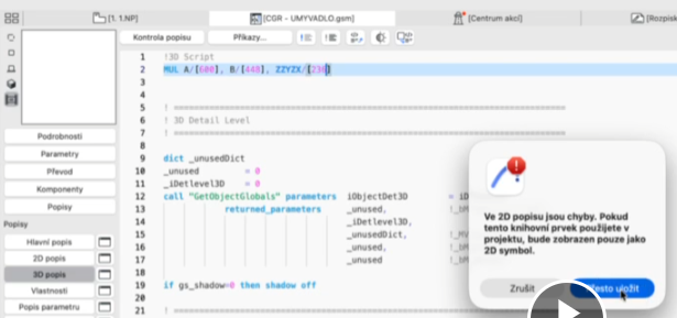

If I add the MUL commands, the object disappear at all. (attach 2)
Could you maybe share more specific descriptions of the workarounds please?

I can't quite see in the video (it is to small on my screen) but you need to get rid of the square brackets.
So you would just have something like ,,, A/0.75
0.75 being the original width of A for your object.

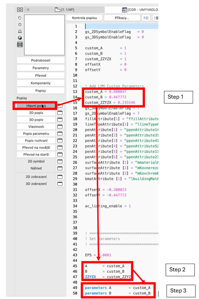

hi,
in reply to Jakub Nohejl - arch
The problem is in the master script,
custom values are made,(step 1)
custom_A =0.600047
custom_B =0.447772
custom_ZZYZX=0.235546
then a,b,zzyzx are set to those values ,(step 2)
A = custom_A
B = custom_B
ZZYZX = custom_ZZYZX
then the parameters script writes those values back into the stored values of the object,(step 3)
parameters A = custom_A
parameters B = custom_B
parameters ZZYZX = custom_ZZYZX
remove (step 2) and (step 3)
Note:
Hideparameter "A" removes "A" them from the list/ info pallet
Lock "A" turns the content of "A" grey and makes it so it cant be edited
Parameters A = setvalue will seem like they are edited, but will immediately overwrite the value back to setvalue after you change it.
Hideparameter ALL "A","B","ZZYZX" removes all from the list/ info pallet except the parameters listed after the ALL command, so A,B,ZZYZX would be shown in this case, but all the other parameters would be hidden.
also
For Lingwisyer script,do not put the values in Square Brackets so
mul2 a/[600],b/[448] will not work,
that is why you get errors when you save it.
Square Brackets are used for array positions,
Round Brackets should have been shown.
Units shown in GDL are expressed in meters,
so 600 = 600m,
and 0.600 = 600mm
so mul2 a/(0.600),b/(0.448) would work.
The action center will point you to the log which will tell you what lines of the script are not working,
see the red dot in the tab above,
follow the red dot,
go to the report that is red in the action center...
you could try changing the Lingwisyer script to use the predefined values in the master script for the size in (Step 1), after deleting (Step 2) and (Step 3) :
!2D Script
MUL2 A/custom_A, B/custom_B
!3D Script
MUL A/custom_A, B/custom_B, ZZYZX/custom_ZZYZX
I hope this helps
