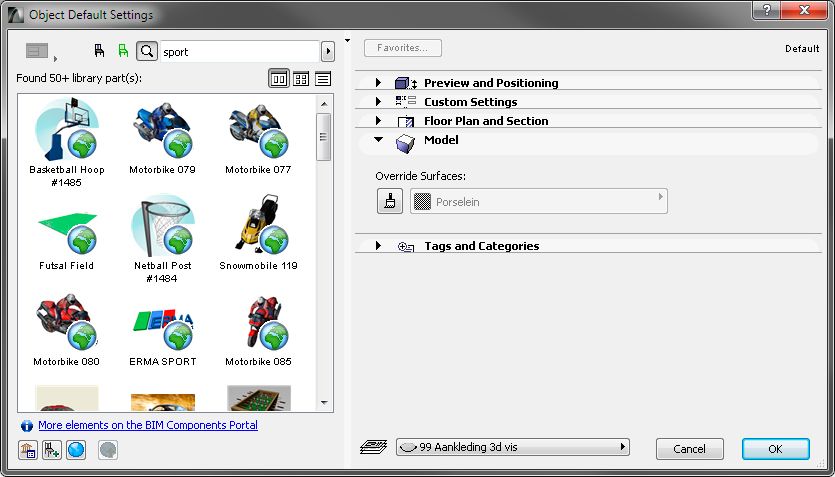

I would recommend having a company / project library next to the standard ArchiCAD library. If you are ever sharing your work with someone else (outsourced or same office) they would need to have your customised standard library, or they will be missing those parts.
If you want to find all sports things (for example), there is a search function, which takes into account keywords embedded in the library parts. This is even faster than browsing to one folder inside the library, once you get used to it. You can even have it search the bimcomponents portal for any extra parts you might not have.
You can set up the keywords in the details tab of the library part if you edit it.
