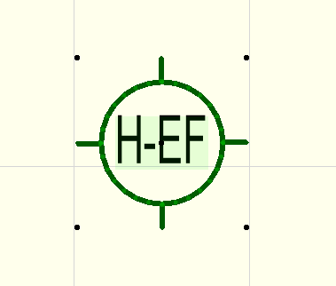

I've made a 2D light symbol and saved it has an object.
Changed it's subtype to light.
Works fine except I'd like to get rid of (or bring in closer) the outer
4 bounding points shown in the attachment.
I've searched though the 2D script but don't see any obvious place to
adjust this.
Any hints appreciated.
Thanks

Hello,
You can erase the 'hotspot2' lines to get
rid of them. The problem is that there needs
to be at least one hotspot or the bounding
hotties are created by default.
You could add desired hotspots in the floor
plan before saving as an object.
I recommend placing the symbol to the origo
(0,0) before saving. That way the code is easier
to read + edit. For example you could just add a
line
hotspot2 0,0
to have one in the
middle.

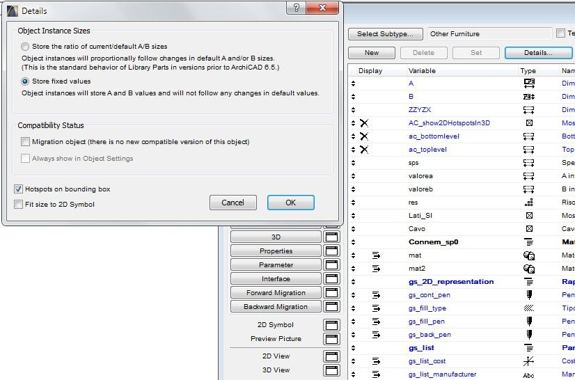

Hi lec,
to get rid off that hotspots you must select the "Details" button on the Parameters window and uncheck the item "Hotspots on bounding box"; then Save the object.
...and that to happen you must have at
least one hotspot in the 2d code or in the
2d symbol.

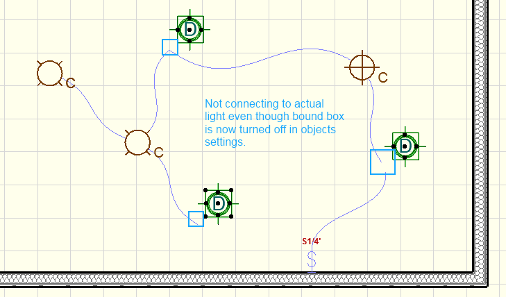

Hi Andro and Juha again
Thanks for the replies.
Got the bounding box turned off per you suggestion, thank you.
(And added extra hotspots near the light as I'm sure you can see.)
But the wires still don't go to the light or my inner hot spots.
They still seem to go to the bounding box corner locations even though they are turned off now.

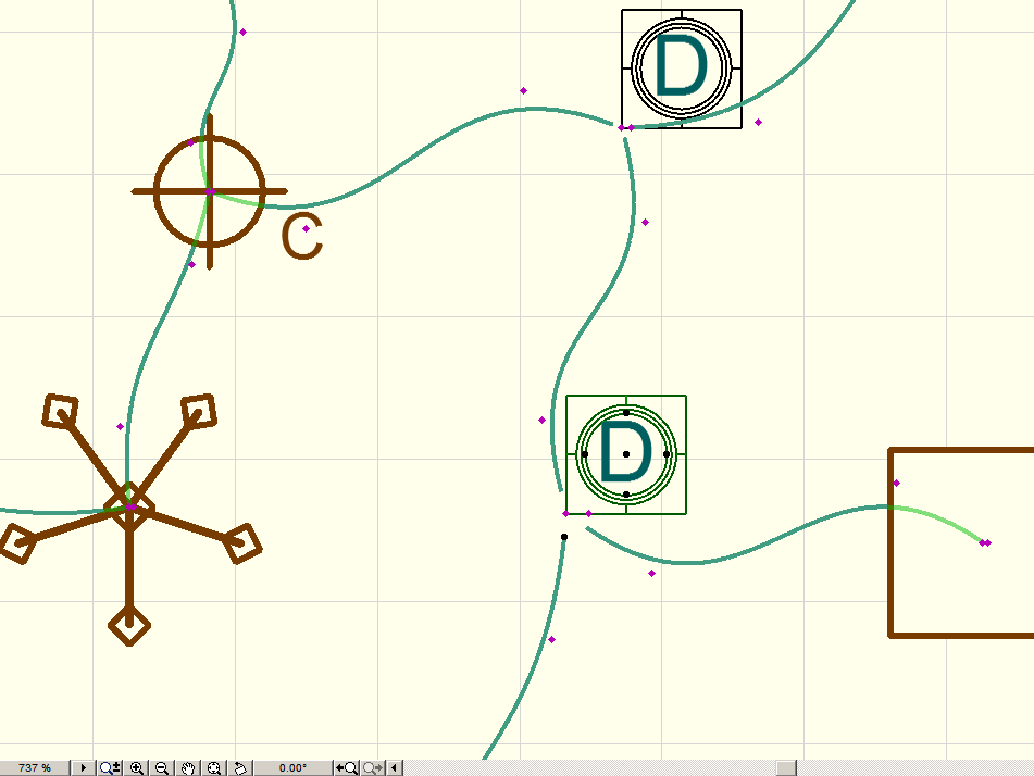

Maybe I should explain a bit.
I've just purchased Cadimage's Electrical object and it works fine for standard
AC lights (the round ones I'm showing).
However AC doesn't have several of the light symbols I want, so I'm trying to create my own.
Problem is if I can't get my lights to have wires come all the way to the light, (as the others are) it can be a confusing view, ie. (is it to that light or not?)
Don't think this is a Cadimage issue, as it works fine with AC lights but will try Monday if no solution by then.
Current script follows:

Hello,
Did you save the object with the center of
it in the origo, not the lower left corner?
Juha wrote:
Hello,

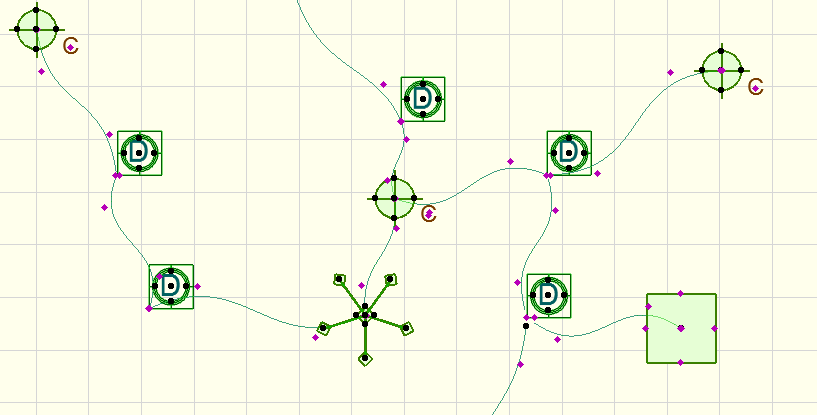

Hi Juha
Not then, but now I have.
Did not seem to change anything.
I noticed that if I shortened the 4 lines leading out from circle then the connection point would follow to the effective intersection.....
So, by having the 4 lines inside the box is better but still elect lines are only going closer to the lower left of box no matter how I place the light, unlike AC's lights which have connection points at the center.
I tried a version where there was only one hotspot at the center of my object and centered on the origin, which did not help.
So somehow there is something different about a factory AC light and my
AC generated "D" light.
Certainly much more usable now, but still curious why not to the center
hotspot when there was only that one.
Thanks for all the help All.

lec:
If the wires are generated by the Cadimage Add-On, then you will need to contact them or look into the scripts of their objects to see how this is handled.
