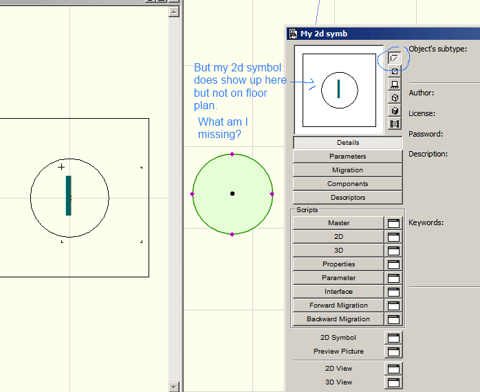

I'm trying to figure out how to change the 2D symbol of a copy of a stock AC light.
9 REPLIES 9

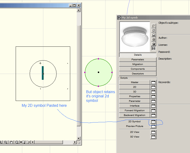

and....
The problem is you are drawing your object in the 2D symbol window.
This is fine but if there is any script in the 2D script then that will be used and not the 2D symbol you have drawn.
You will need to comment out all of the 2D script if you don't want to use it or use the FRAGMENT2 command to access what has been drawn in the 2D symbol window.

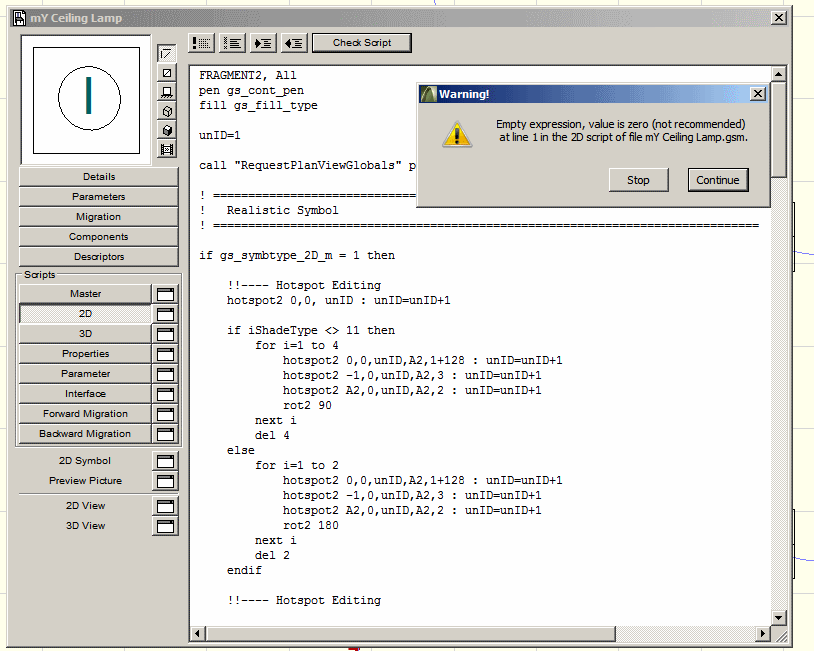

I've tried ! commenting out all the lines in the 2D script which makes the stock 2D floor plan view go away, but my 2d symbol does not show.
So I looked in the GDL reference guide and found the Fragment2 command.
However in trying what I thought were all the variations shown, I kept getting errors when I did a check script.
and...
Some of the other variations of the Fragment2 command I tried got different warnings, but no matter what I tried, no go, except for one error message said when I went to save anyway, was that if I continued it would not use 2D script, and use my 2D symbol, but it didn't.
rocorona
Almost sure, you left something there. If the GDL interpreter finds anything "readable" in the 2D Script, will try to use it instead of the 2D Drawing.
You copyied the command as it is on the manual, but you didn't read the "CONVENTIONS USED IN THIS BOOK" paragraph (p.13). You must write as in syntax only the words in capital letters. Generally, the others are to be substituted by values (or variables)
So use:
FRAGMENT2 ALL, 0
or
FRAGMENT2 ALL, 1
(with the first one the drawn elements retain their attributes, with the second one the current attributes of the object will be used)
In the other your post the error is generated by the comma between "FRAGMENT2" and "ALL"
To stop the interpreter after it executes the FRAGMENT2 command, add a row with the END command, or simply delete all.

Tried both of the Fragment2 commands you listed to see the difference (and the END).
Worked perfectly
Thank you Roberto
Good thing I don't write code for a living:-)
