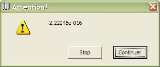

As the multiplication trick isn't correct, I decided to use the definition of the MOD function :
X MOD Y = X - Y * INT (X/Y)
When applied to X=1.2 and Y=0.4, the result is :
-2.22045e-0.16... I know this is very small and wouldn't be a problem on site , but I thought the result should have been 0

You've run into numerical discretization error that results from computers using binary arithmetic. Decimal fractions cannot be represented precisely in a fixed number of binary digits (bits) - and therefore some truncation occurs. This numerical error is magnified when arithmetic is performed, particularly subtraction which can leave nothing but the error remaining. The branch of Computer Science/Mathematics called 'Numerical Analysis' deals with these issues and more.

which is pretty tiny after all .. but is certainly not zero. I talked about this on GDLTalk a while back - and which is probably where this conversation belongs, except that I cannot post screenshots there. One needs to allow for this numerical error with some kind of factor, epsilon, and realize that the result will be within +/- epsilon of the true result. In this case, anything that is between + or - 1E-15 could safely be said to be zero. As you say, for construction purposes, we could set epsilon to be much larger and still call it zero.

Row 4 shows the next VB function - same formula but with double precision values and arithmetic. Pretty odd, yes? It gives the 0.4 value that you got from ArchiCAD - which suggests to me that the ArchiCAD implementation of the MOD function is incorrect. The reason is easy to see. INT(X/Y) evaluated to 2 instead of 3 - thus giving the result of 0.4. Well, how can this be? Simply because INT truncates (chops) the fraction from a number leaving the whole part. If the result of the division was 2.999999999999999 then the result of the INT would indeed be 2. Why all the 9's? Same deal as above.
Row 5 shows one solution to implementing the MOD function - and the result matches exactly line 1, which is the Excel built-in MOD function. Here, I added an epsilon factor of 1E-15 to the result of the division to balance the numerical error. In some case, I might get 3.000000000000001 or slightly more, but for the MOD function this doesn't matter, since INT will chop it all off.
Whew. Looks like you did find a bug to report to GS, though!
