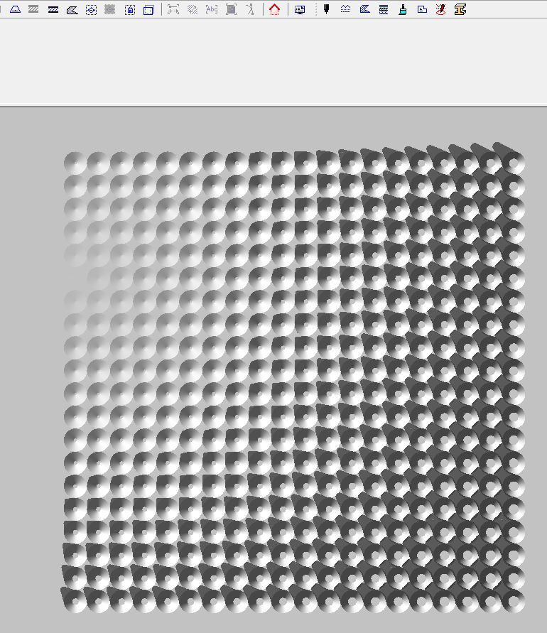

It would be really nice to have such a command, especially when it comes to measuring distance between two points defined in 3D by X, Y, Z.
Measuring is very useful when trying to do such a thing (point attracted cones):

For the above example I used a moveable hotspot inside the GDL Object as the attractor. This is why I can make many options of it a few seconds:
