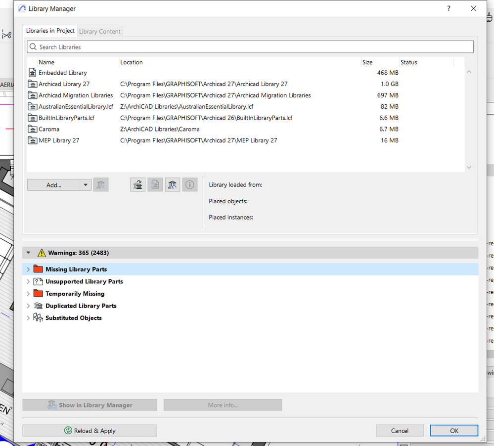

Hello,
We're experiencing an issue with doors and libraries not loading correctly in Archicad 27 after migrating a project from Archicad 26.
We've tried copying and pasting from the Archicad 26 file, migrating libraries, inserting objects, and reloading all relevant libraries correctly - but nothing has resolved the issue. Everything works fine in Archicad 26, but in Archicad 27 the doors and associated libraries will not load (I can copy into a new plain file).
Could this be a bug, or is there a known solution?

You are using the same language version for the 26 & 27 libraries?
Different language version objects are not compatible.
Otherwise there should be no issue, especially if you are loading the migration libraries together with the 27 library.

So the Library Manager shows a "missing" library and warnings of "missing" objects?
Can you show a screen shot of that dialogue?
Hi Barry,
No libraries show as missing but library parts do (I tried reloading all libraries plus I also tried adding others and copy and pasting (not captured in screen shot)).
Libraries seems OK.
Can you expand some of the warnings to see if any of the windows are missing?
There may be a clue in there.
I am wondering if they are in the 'unsupported' group.
Hi Barry,
You are correct, they are under 'Missing Library Parts' under 'Archicad 27 Library'. However - How do I resolve this? I have tried reloading that library many times but it doesn't update.

Hmm, this is strange.
They are all doors and windows from versions 24, 25 & 26 - which is fine.
Having the migration libraries loaded, these should migrate to 27 objects.
I notice you have a library loaded called 'built-in library parts'.
You don't need this as Archicad automatically loads that file anyway from the current version program folder.
Delete it and re-load and see what happens.
If they are still missing, I can't think why.
