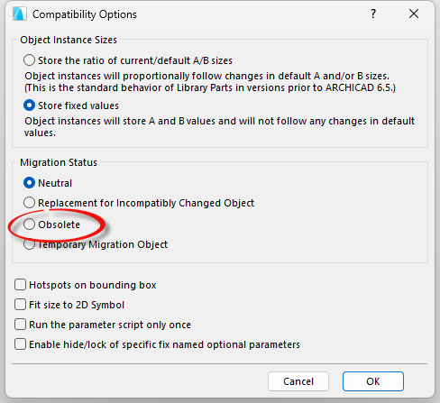

You should be able to load the actual Archicad 24 library if you have it.
Then you will have access to the actual objects.
The ones in the 24 migration library are marked as 'Obsolete' which is why you can use them if they exist in your model, but you can't see them as new objects.
So even if you extract them and save in 28, they will be marked as 'Obsolete'.
You can change this by opening the object script and going to the 'Compatibility Options' page.
Once you have placed the object from the 24 library, you can unload it and the migration libraries will continue to work and give you access to the placed objects.
Or if you have another file that uses that 24 cabinet object, you could copy and paste it into the other file.
Durval
Thank you, Barry, there's always a new trick to learn!
We can also simply drag the object from the extracted Migration Library to the plan and it will show up. No need to change anything in Compatibility options.
