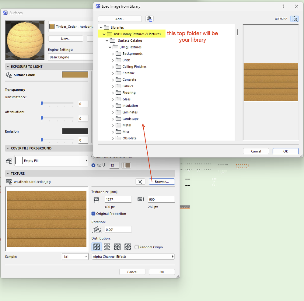

halzsa
The exact warning is related to the surfaces. As far as we can tell, everything else works correctly regarding the attributes, but the surfaces are missing. If the surfaces work correctly in the offline files, is there a way to identify which library contains them and load that library into the Teamwork file?
They are the image texture files that the surfaces use.
If you are not sure what library contains those image file, open the stand alone PLN that works.
Open the settings for a surface that uses one of those mossing textures.
Press the BROWSE button to change the texture and you should be able to see the file path and the very top folder should be the library that you need to load.
