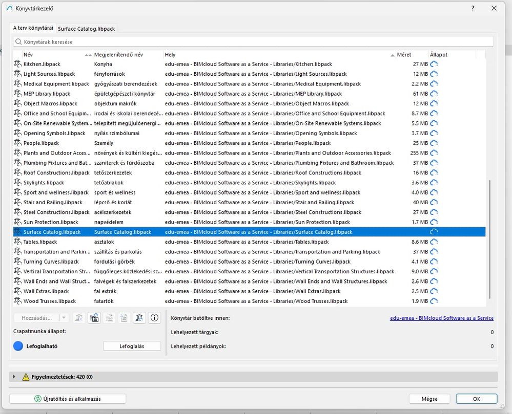

Hello,
We are experiencing an issue with missing library elements in an Archicad 29 Teamwork project.
Some library elements are missing their required attributes, and we are not sure how these attributes should be loaded or restored. The elements themselves appear to be missing or incomplete because the related attributes are not available in the project.
This is a Teamwork File, and we are using an Educational Version of Archicad 29.
Could someone please explain how we can properly load or restore the missing attributes for these library elements? We would also like to know whether there is a specific workflow for handling this issue in a Teamwork project.

It happened immediately after sharing the file. Each member tried creating a new file and sharing it, but as soon as the file was shared, the attributes went missing. Could this issue be related to some kind of AC 29 update?
Maybe we could try loading the attributes library from AC 27, which we used previously. I don't know if that's possible, though.

halzsa
The exact warning is related to the surfaces. As far as we can tell, everything else works correctly regarding the attributes, but the surfaces are missing. If the surfaces work correctly in the offline files, is there a way to identify which library contains them and load that library into the Teamwork file?
They are the image texture files that the surfaces use.
If you are not sure what library contains those image file, open the stand alone PLN that works.
Open the settings for a surface that uses one of those mossing textures.
Press the BROWSE button to change the texture and you should be able to see the file path and the very top folder should be the library that you need to load.

Update:
I was trying to solve the problem based on Barry’s recommendations, but AC 29 has changed a bit compared to AC 26 and earlier versions so I couldn't find the libraries on my PC the way Barry shown. I think I may have figured out the solution by deleting the Surface Catalog.libpack from BIMcloud and then reloading and applying it.
Currently, all surfaces have been loaded and there are no issues so far. However, I haven’t had time to test it properly yet, so I hope it stays that way.
Thanks for all the help!
I am not familiar with how BIMcloud libraries work, as I have no need to use them.
But it sounds like you have solved the issue.
However I see you still have 420 warnings.
Or was that image before the update - I see the surface catalogue libpack file has no size.
