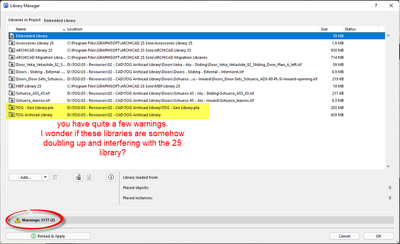

Hey all,
Having a small but annoying issue in my 3D view of a project I'm working on.
I am building a kitchen base unit, using the default Archicad 25 library object.  I have built it all up with a sink, rebated handles and tap.
On the plan, and section they are looking perfect, however in the 3d the tap and the handles are missing.
I suspect that it is an issue with the GDL options and or the MVO, as when i go into the MVO there is a tab for 'Options for GDL objects (Archicad library 17)' and on this tab there is a toggle for showing the tap and knobs - as you can see in the screen grab attached.
If any one can point me in the direction of what is happening it would be really great.
Cheers

The migration libraries explain the 17, 21 & 24 options then - so that is OK.
Strange that 25 is not there though.
You seem to have some other 'Archicad' libraries loaded.
I wonder if they are somehow interfering.
The warnings may show you have a lot of duplicate objects which is always a good thing to avoid.

They were interfering, but not 100% why.  Once i deleted them and reloaded them everything came good.  the other junk in the embedded library was causing most of the issues and once that went all but one of the MVO tabs resolved to A25.
I assume the clash was as my own libraries were in there befor ei switched to 25 and that caused some conflict.
Re the warnings, i have been trying to get rid of those for ages.  They do seem to be picking up as duplicates but cant work out why.  I think its got something to do with my filing system and how that is linked in, but need to sit down and have a root around to work out where the conflict is occurring.

Took a look at the filing - got rid of all but 76 warnings, and these are bits that are missing now so will just have to replace them when i have time or the need...

I think the loaded migration libraries is why you still have the 17 MVO object options.
There must be objects that are still from version 17 that require the 17 MVO.
I am still not sure why you don't have the 25 MVO - it should be part of the loaded 25 library.
I should have read on,
You seem to have solved it.
