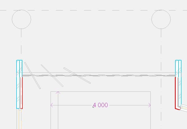

Hi everyone,
Does anyone know if there is a way to use cadimage door and window builder to do a stackable door equivalent to archicad's movable wall..? or other alternatives...
I find the "movable wall" not very flexible at all.... I need to get the door to be closed in elevations but open in plan plus the "wall" (door panels) are non editable like cadimage doors or windows....

(Do you have DWB? or are you asking so you can buy it if it does?)
You can stack as many sliding doors as you like, but as far as I'm aware you cannot get them to sit in a single plane when closed, as a moveable wall does. They maintain the offsets required to run past each other.
Door options available in image below. Surface slider runs past wall, closet slider is typically two doors that run past each other, usually within the wall thickness.
Make sense?

Yes, i do have DW Builder and I'm a frequent user.....
I've included an image to show what I would like to do on plan (the movable wall from archicad). My main problem is that the movable wall is still open in elevation as well as the panels are not adjustable at all in terms of panel types etc.
I've tried to get the effect by offsetting a number of single swinging doors but can't get the effect since you can only control two doors (right and left), what if you have 5 or 6 panels?
I've also tried different options in term of using it as a window (since you can with a window control each individual panel separately) but no luck. I can get the windows to open up correctly but they just wont stack...and further more the plan symbol will not show the actual swing it self...
make any sense..?

I had this condition a while back and I was unable to find a library object to properly handle this either, my work around was to use a door object for sect/elev/3d views on a layer that was hidden in plan view, and just use fills and lines to draw in the info I wanted on the plan. Not ideal, but an adequate work around if you have a deadline approaching
