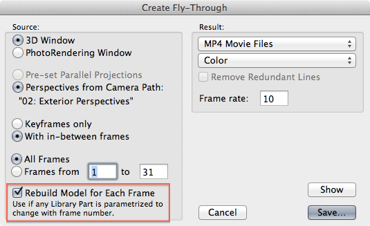

I'm creating a video for a client from the viewpoint of a driver, moving down a slightly curving road at 60mph past the proposal (an installation for a uni project).
I've set up the path with 13 cameras, and 18 frames in between; resulting in 217 total frames. All this works fine and the 22 second video exports great.

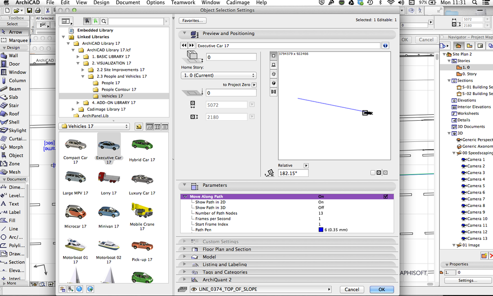

I'm trying to include moving vehicles on the road moving along the same path and at the same speed, and am having problems! I'm firstly trying to use the cars included in the library that have the option to 'move along path', but no matter what settings within that option I use, they don't move. Can anyone clarify what they should be? (image attached)
Secondly I'm trying to animate an articulated lorry in the same way; moving along at the same speed as the camera along the same curved path. Is it possible to do this?
In the Create Fly-Through dialog box, check the Rebuild Model for Each Frame option.

David wrote:
David
Forgot to add I had that checked, it didn't make any difference so I assumed I'd got a value in the settings wrong...

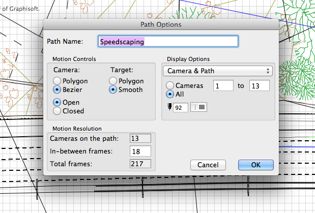

David wrote:
JoeyCAD:
Worked here on a quick test, try posting the Create Fly-Through dialog box and a screen shot of the Cameras Settings and camera path, maybe someone will spot the problem.
David
I did try a test myself in another file with no luck, so it's almost definitely something I'm doing wrong!
Attached should be the path settings, camera settings, fly-through settings and the car objects follow path settings that I've been using with no luck!
Any advice would be great, thanks!

David Maudlin
Rockstar
JoeyCAD:
I got the car to move, but you need to adjust the Frames per Second in the car's parameters to match up with your animation timing.
