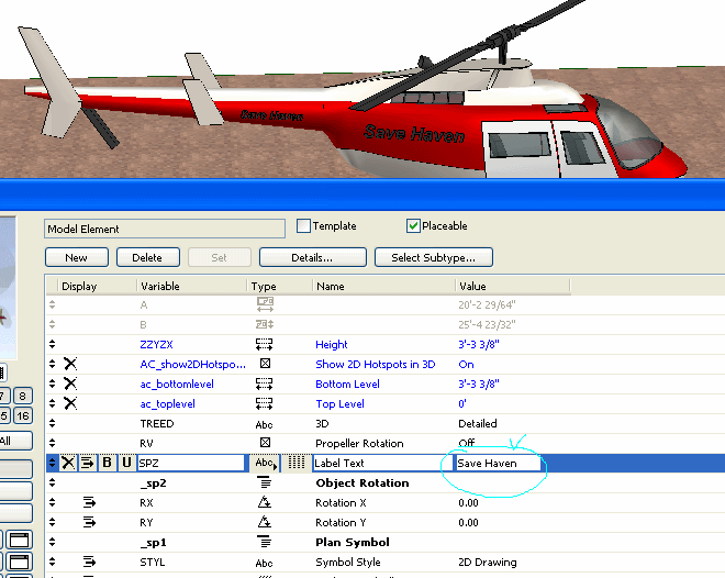

Hello,
Is it possible to get a "return" to work so I can have another
line of text below what I've shown in the attached script?
Thanks
lec

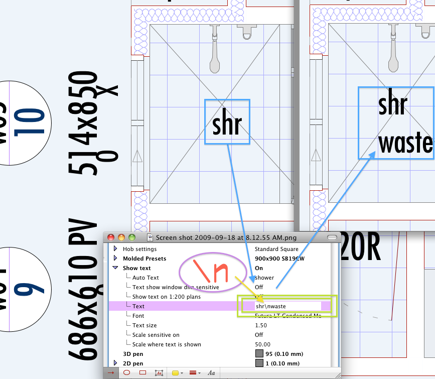

lec1212 wrote:
/.......Is it possible to get a "return" to work so I can have another
If memory serves me well it was ML who suggested to us \n as shown in attached
Works in 99% of cases. Not custom dimensions or label ID
Add for a 3rd line works also. ---\n---\n---

Hi Rod
Thanks for simple approach as I'm not a gdl guy.
However so far I've only got the box shown in screen shot.
And I have tried many variations (spaces-no spaces etc) (just for fun) with no success yet.
Thanks for the idea though.
lec
I think this may be because it is 3D text and not 2D as in Rod's example.
Interestingly \t works (tab).
But then that is not forcing a new line.
Yep works fine if you add the text to the 2D view.
Must just be a 3D thing.
Thanks for additional info Barry.
lec
